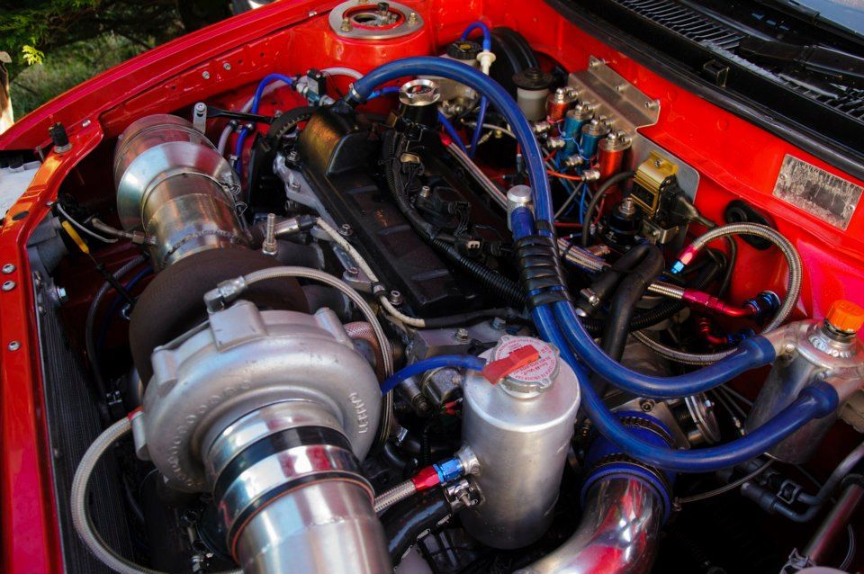

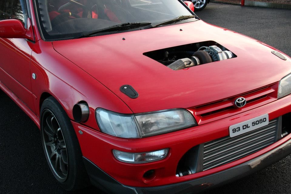

member on toc-irl has this in his corolla...
its going to be pushing roughly 900bhp on meth and its a 4WD Twisted Evil

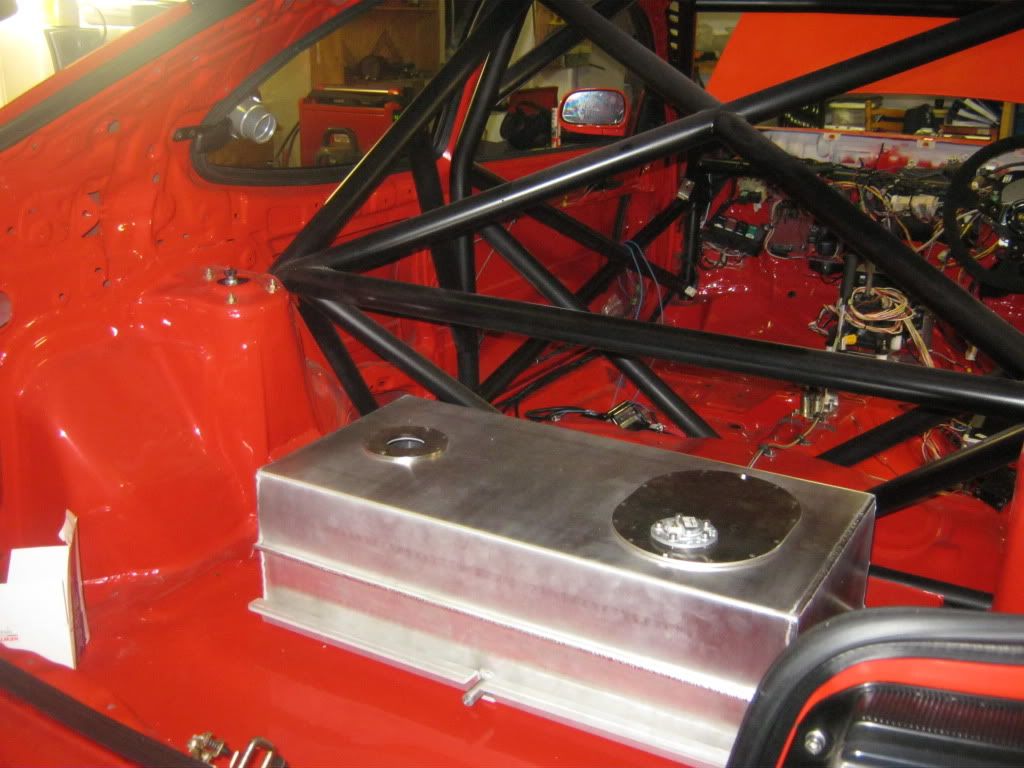

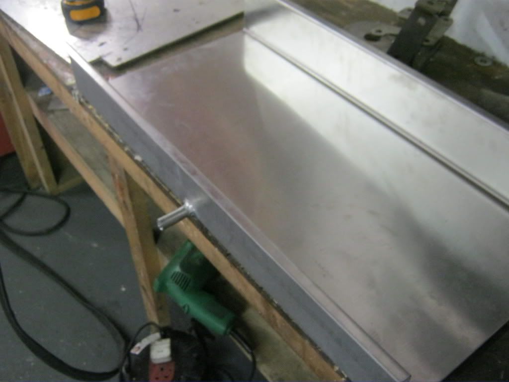

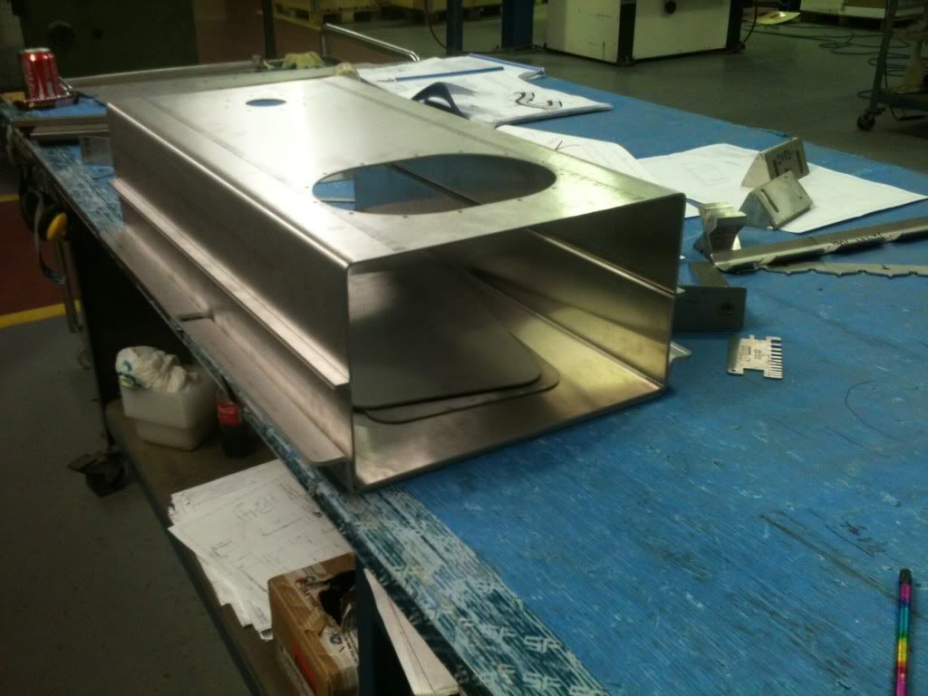

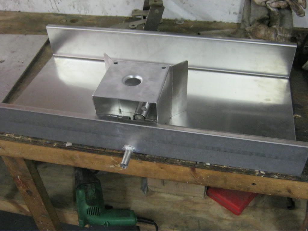

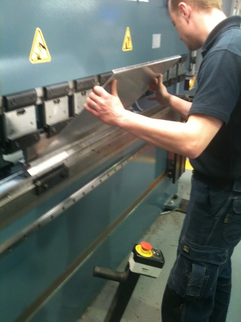

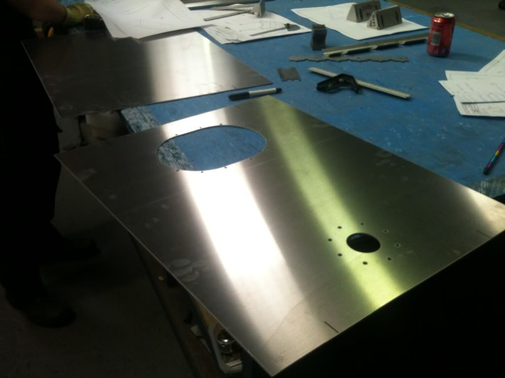

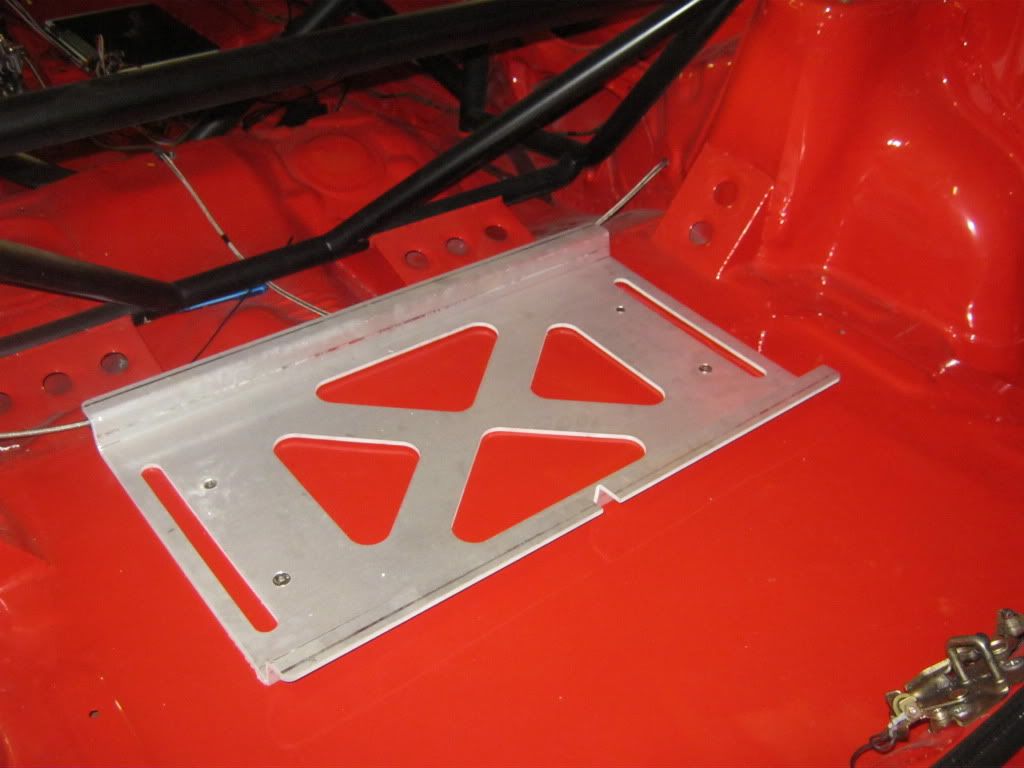

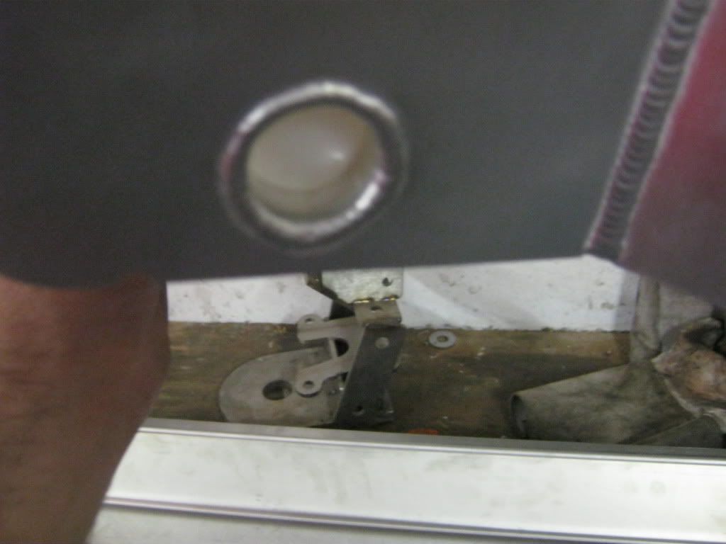

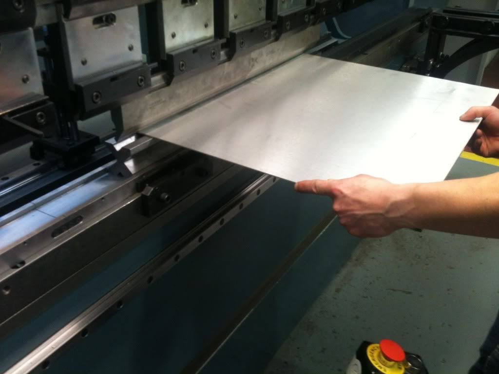

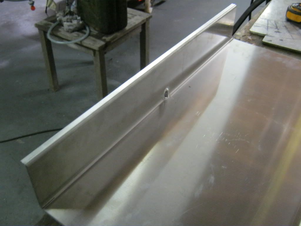

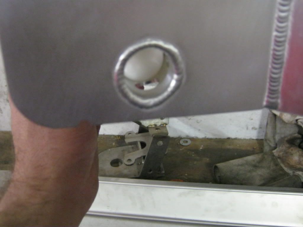

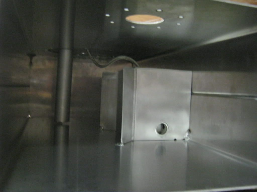

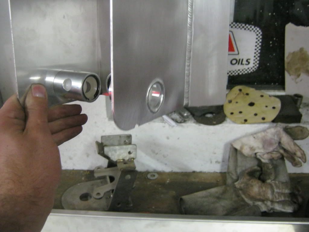

heres the fuel cell i was talking about, its one alan for his own car
Then folded

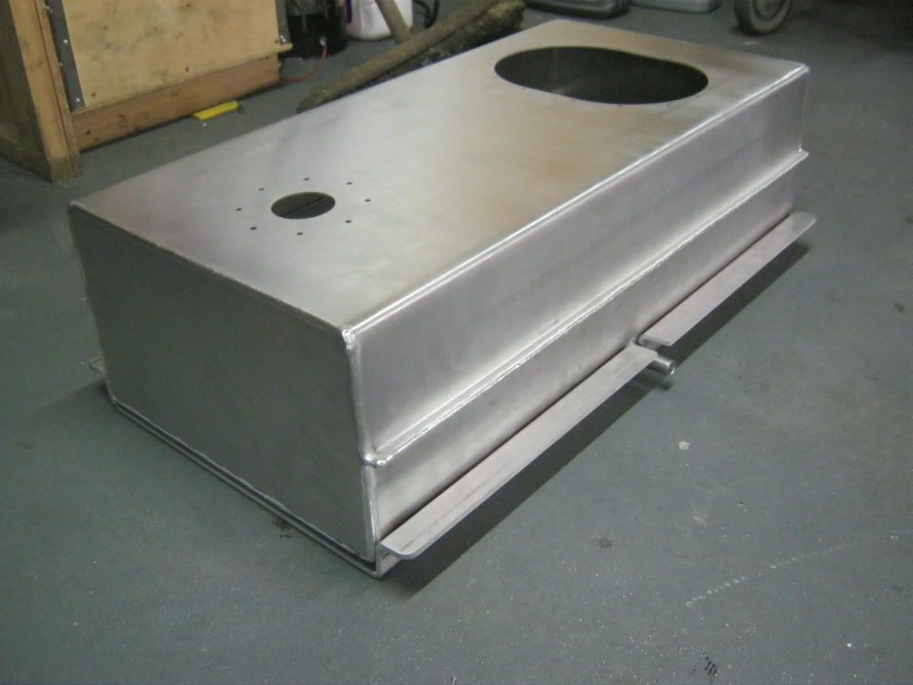

Then Welded on the outlet
Internal surge tank
It has these displacement balls to trap fuel in side
Fuel gauge and return line into collector
all welded up

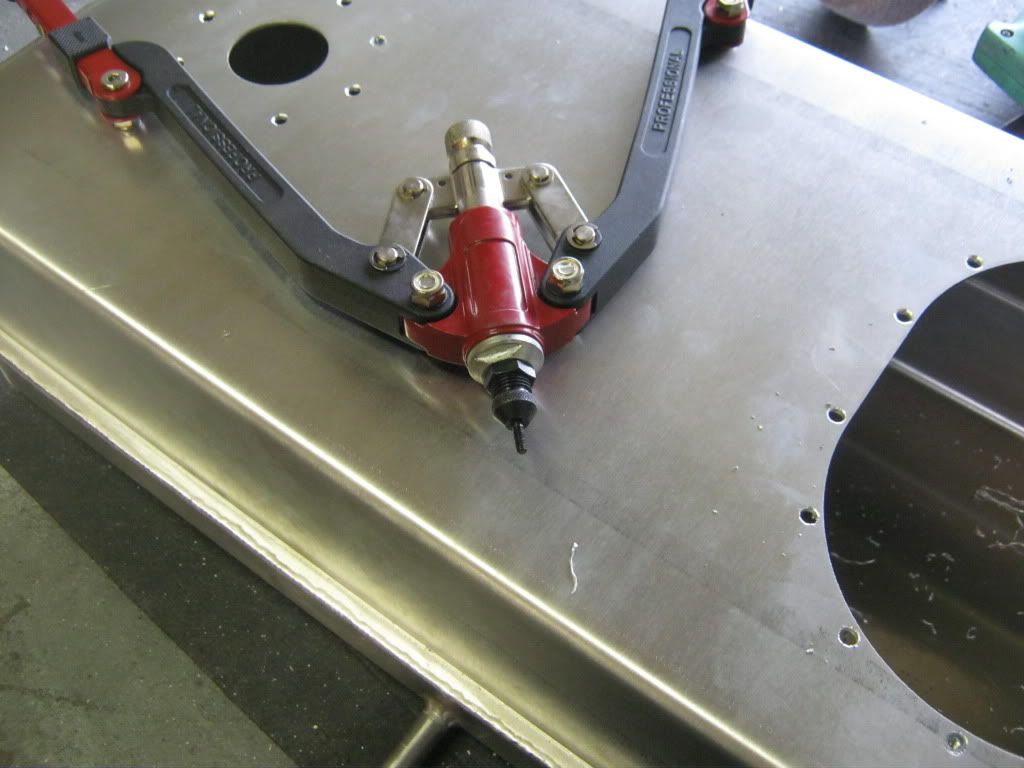

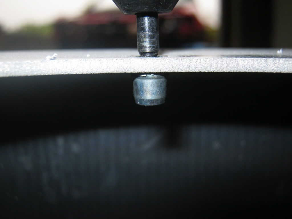

Rivnuts to bolt on inspection plate and filler flange
Fitted mounting tray

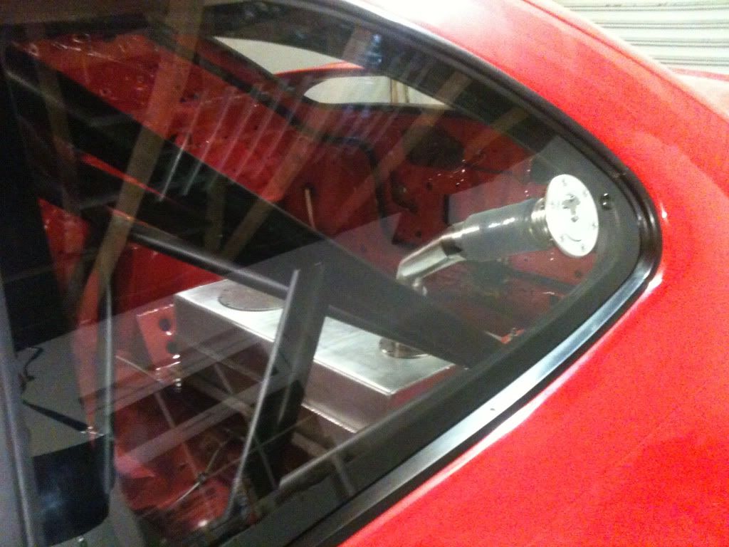

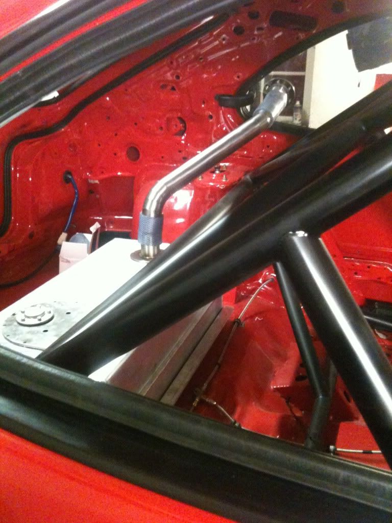

Remote filler

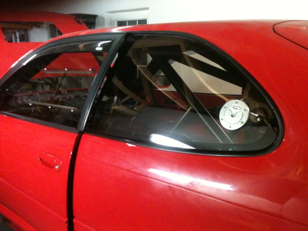

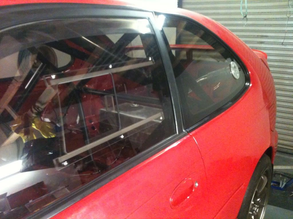

Also got my window done in lexan with plastics for performance they did a really good job.
