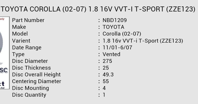

Iv got the twinpots, going to get corolla tsport discs (275mm x 49mm x 29mm) and mr2 pads, just need to get st202 carriers now..

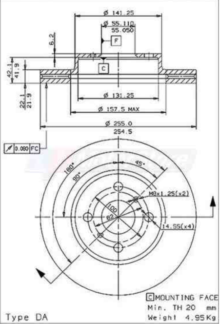

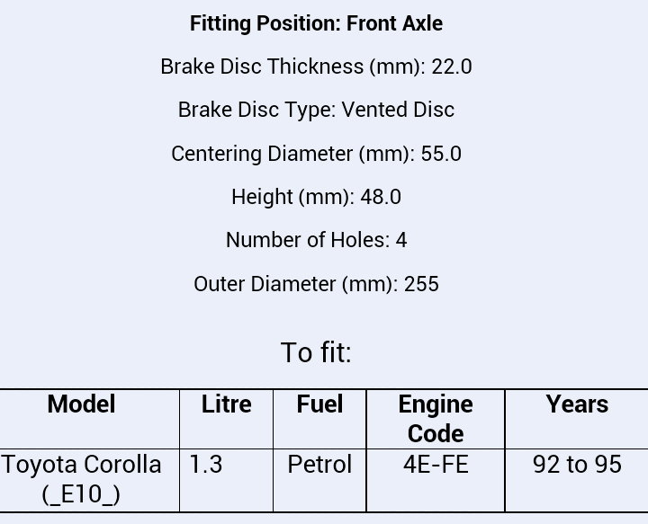

PostSubject: Re: Levin SS Twinpots on Stock E10 Mac Hub   Wed Mar 20, 2013 10:39 am
Its a 55mm centre bore.. shouldnt make a big difference right?
PostSubject: Re: Levin SS Twinpots on Stock E10 Mac Hub   Wed Mar 20, 2013 10:47 am
^ Yes it'll make a huge difference. 1mm will cause loads of vibration as the disc won't be sitting on the hub nice and snug. You need 54mm bro.
PostSubject: Re: Levin SS Twinpots on Stock E10 Mac Hub   Wed Mar 20, 2013 11:04 am
Bro I think you got it wrong
From wherever I have read the e10 came with 55mm bore not 54mm. Starlets had a 54mm bore
PostSubject: Re: Levin SS Twinpots on Stock E10 Mac Hub   Wed Mar 20, 2013 11:09 am

Kinda researched more and we kinda agree we are both right
55mm centre bore
PostSubject: Re: Levin SS Twinpots on Stock E10 Mac Hub   Wed Mar 20, 2013 11:39 am
^ Haha yeah, after an intense conversation and plenty of research we can agree that it's 55mm, but it's still a grey area (meaning I'm not 100% convinced until I measure my own since there's so much conflicting information out there, lol).
PostSubject: Re: Levin SS Twinpots on Stock E10 Mac Hub   Wed Mar 20, 2013 11:45 am
Oh yeah until we actually check we have no idea if its 54 or 55.. but I hope its 55mm Razz
