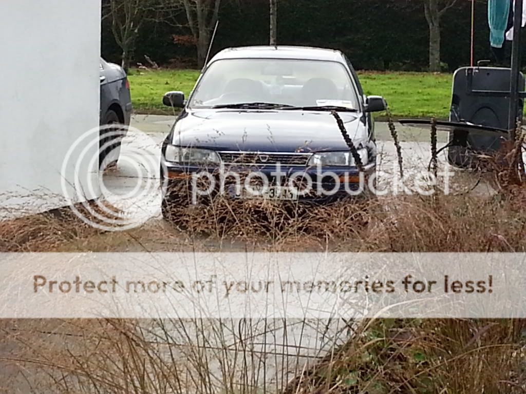

Well lads been on this for a while now so said i might aswell start a project thread.I bought my corolla last november.
Its a 96 brilliant blue pearl xli and i'm the third owner on it(the previous owner was an elderly lady and had the car since 2000).
Anyway here's some pics of when i got it.....

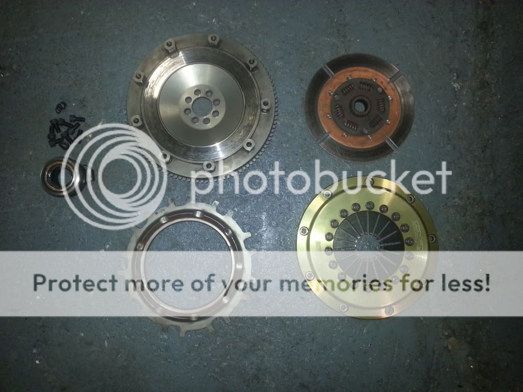

Ok its been a while since i've been near this so i think its time for a bit of an update.First things first,i got a few small bits.
Got some levin wheels and new tires along with a set of moulded mudflaps which i sprayed matt black.
Facelift rear lights.
And corolla xc grill.

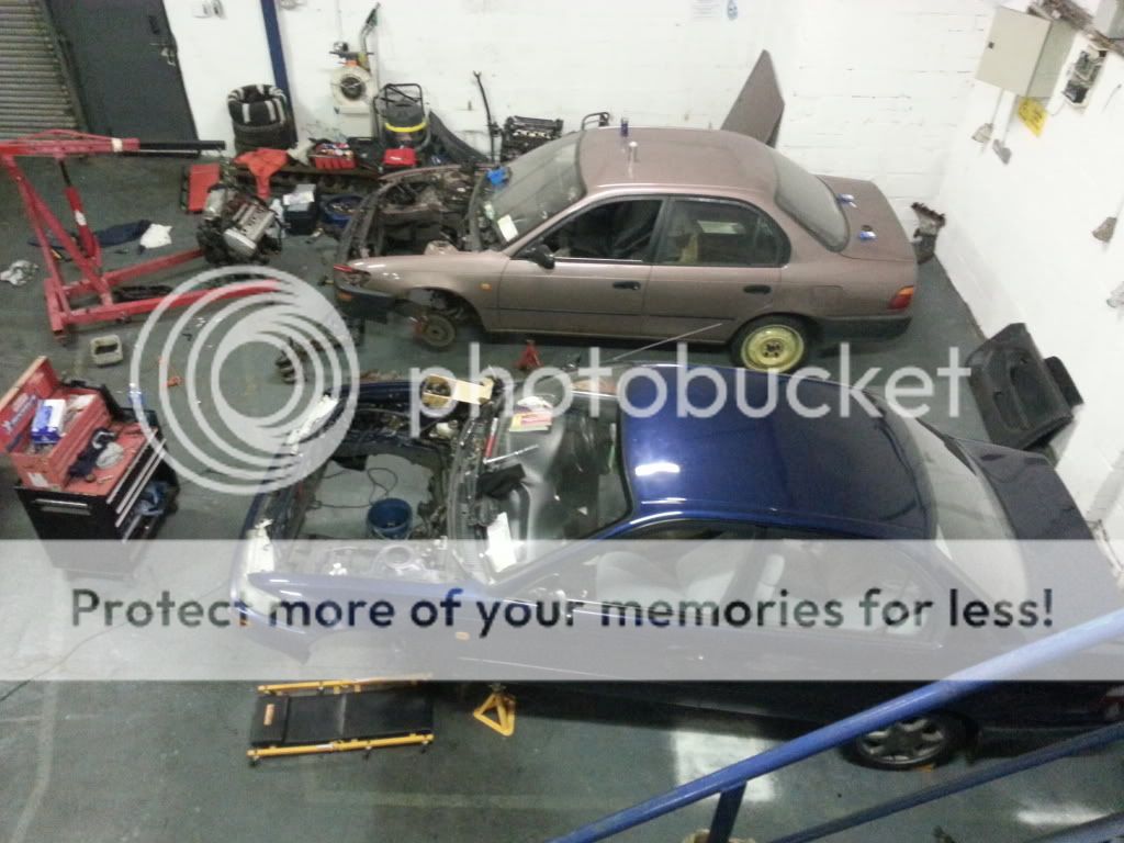

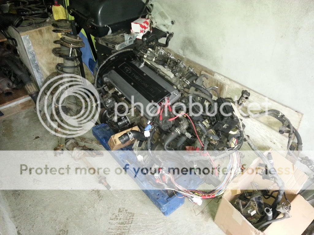

After that i started stripping down the doner car.So i got out the engine,superstrut ect...
So i left it for a while and just started collecting some goodies Very Happy
[/u

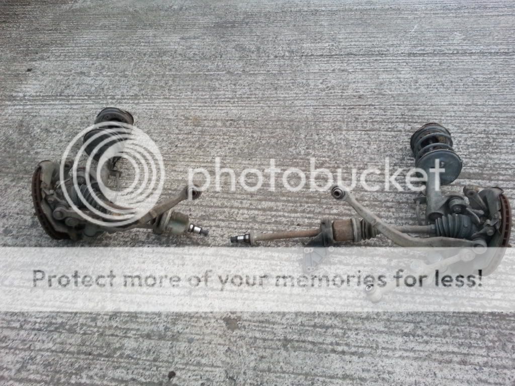

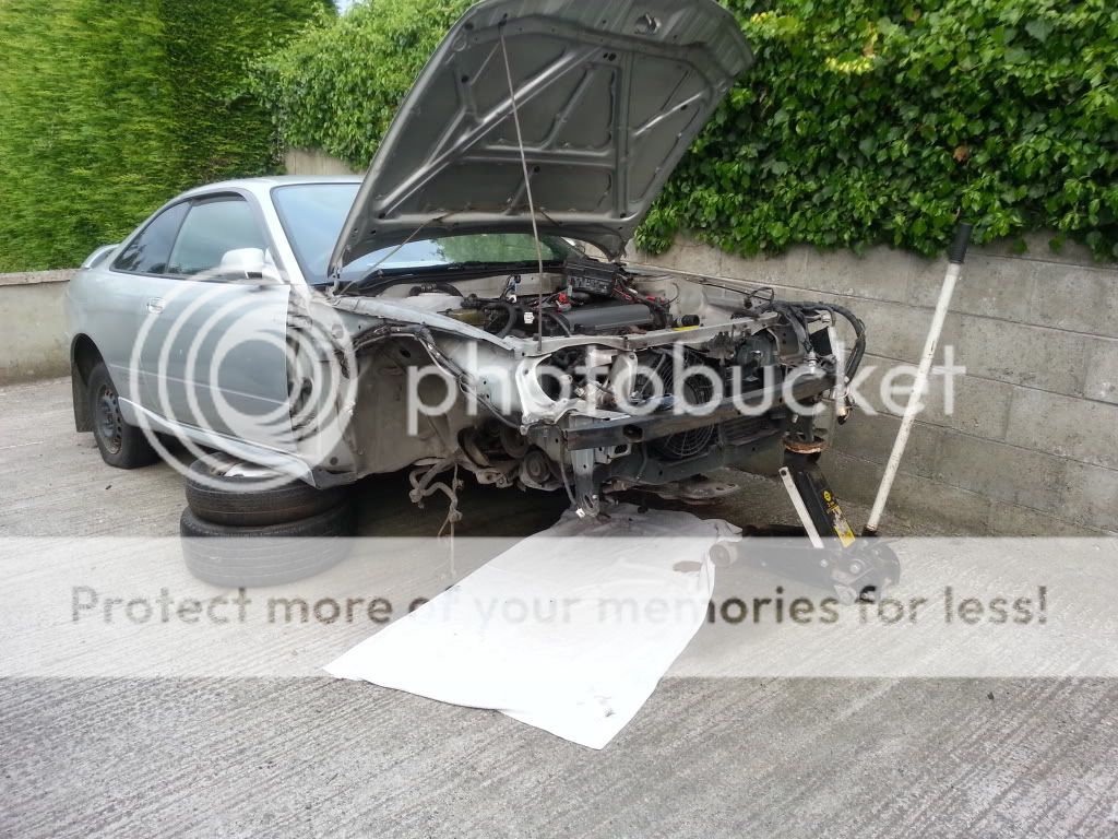

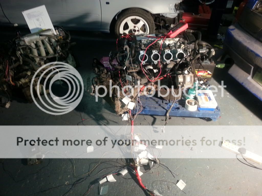

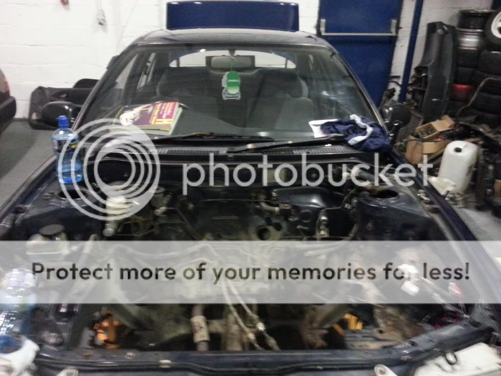

About 2 weeks ago i started working on the conversion in my spare time.
So the first thing i done was get the engine and suspension out.

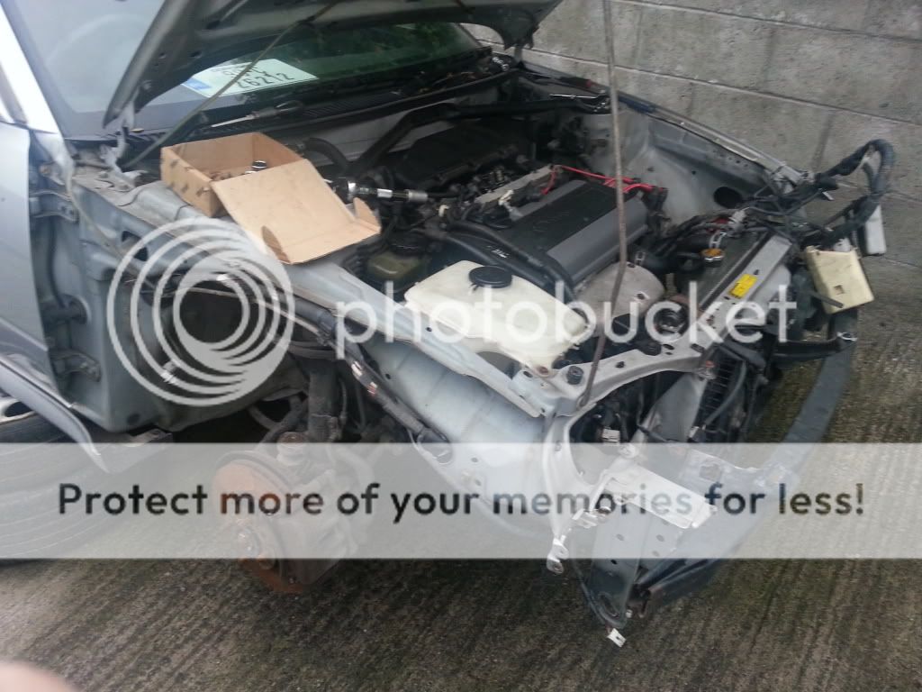

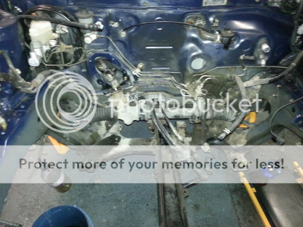

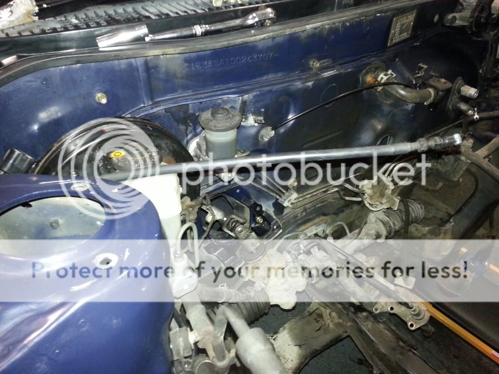

Then i started stripping the bay out and first to go was the brake servo.

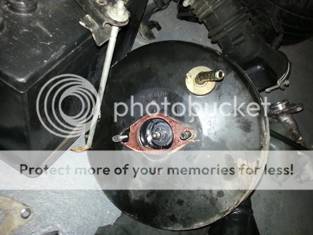

The servo on the corolla only has one vacuum whereas the levin has two.
This is prob to keep vacuum on both sides of the of the itb's so there won't
be an imbalance and i believe on the 20v corolla's its tee'd off at the servo.
Anyway here is the corolla servo.
And here is the levin servo fitted.

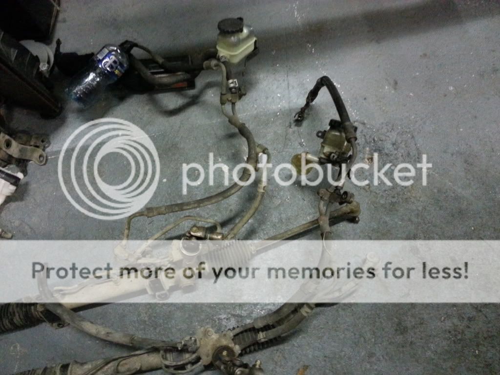

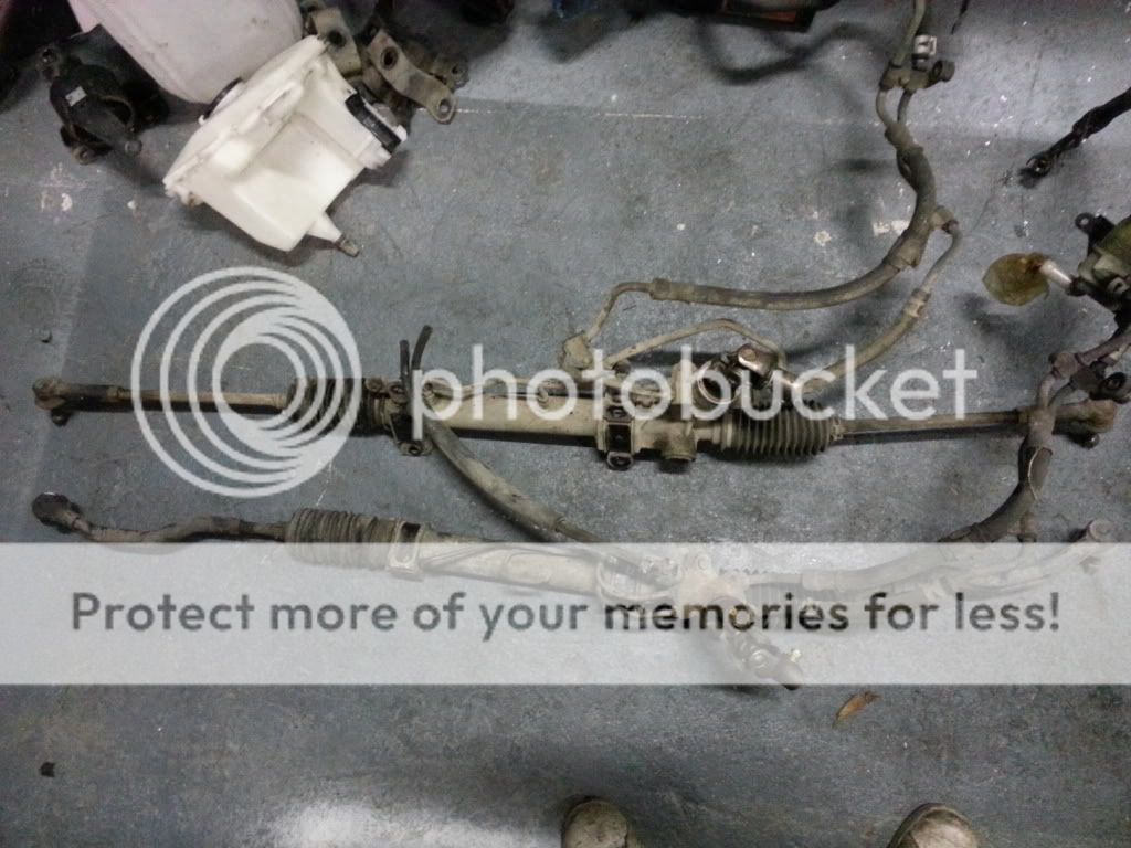

When that was done i changed the the power steering rack.I done this because to run the blacktop pas pump
you will need custom lines if you chose to retain the corolla rack.Just a quick note,you don't have to change the rack to use super strut afaik.I believe its just tie rods and track rod ends that need changing.
Corolla on the top and levin on bottom.

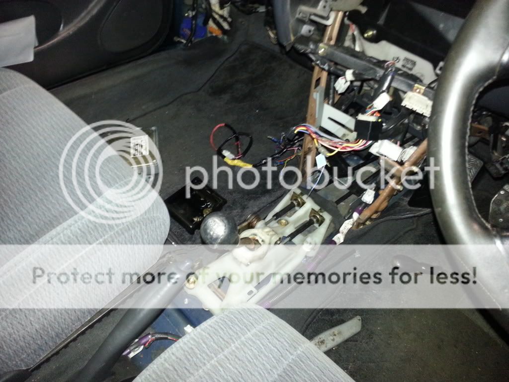

I was going to be using the c160 6 speed aswell so i had to change the shifter and linkages.

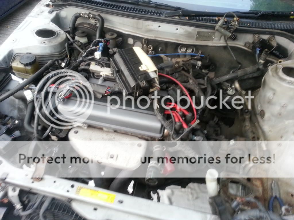

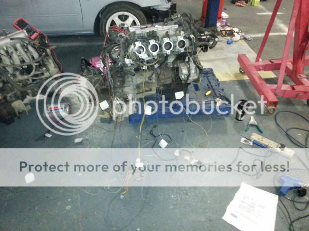

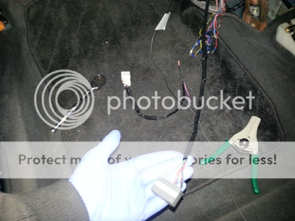

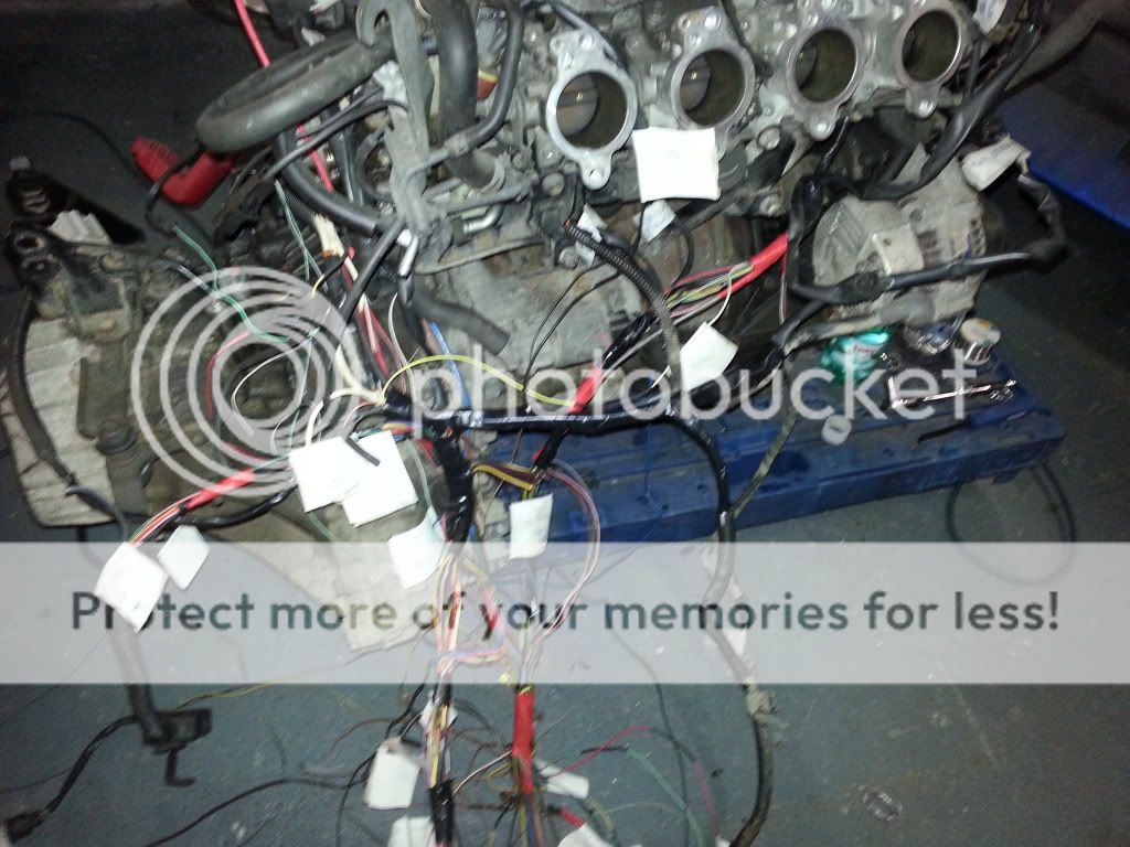

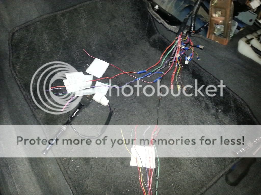

Got started on my wiring,basically merging the body part of the 4efe loom to
the engine/ecu part of the 4age loom.
In the e10's the last ecu plug is part of the dash loom instead of just going straight
out to the fusebox on the e11's.So i had to make the third plug of my blacktop ecu
part of the corolla cabin loom.
So just sat the engine in on the two subframe mounts and plugged in the loom lastnight.
Dash lights,head lights and all body related electrics are working.
I couldn't start the car as i had no oil and nothing else was hooked up.I will check over everything with the multimeter first and go through it top to bottom before i plug in the ecu and try to start it.When the car has been running fine for two or three days i will the the loom back out and sleeve it properly.
