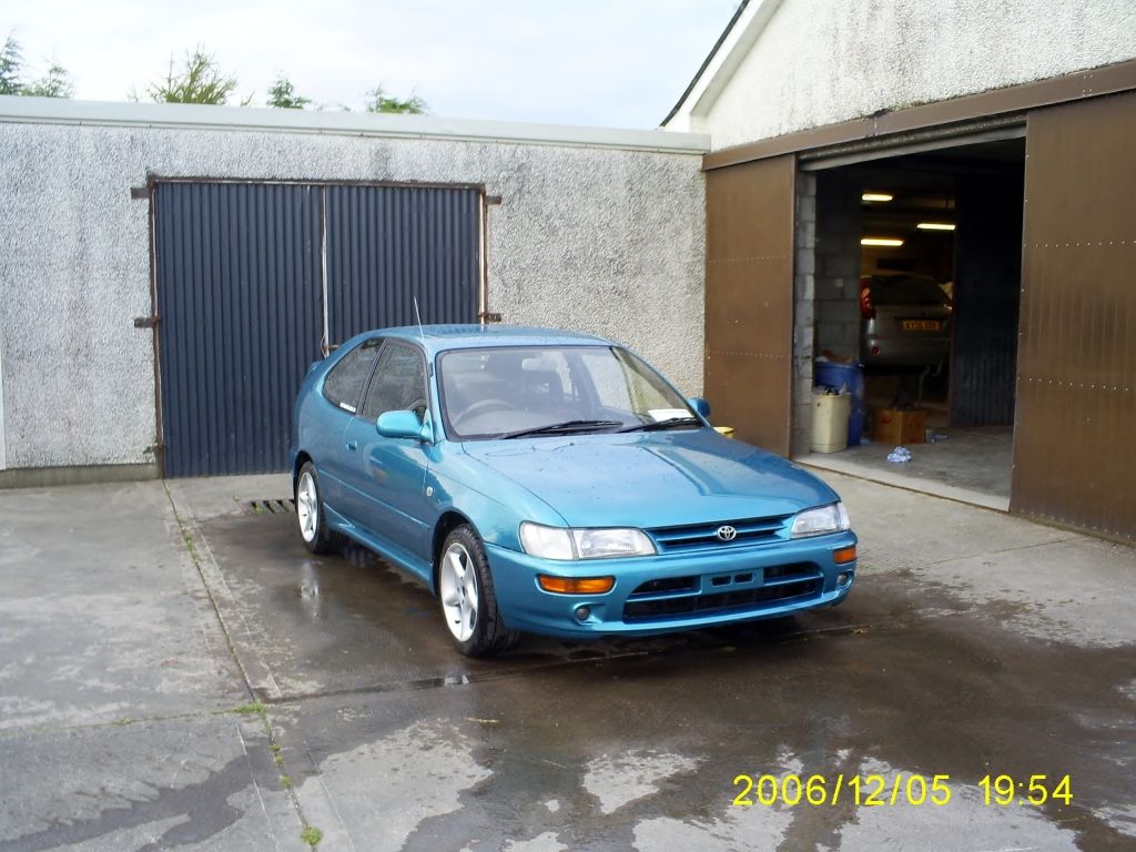

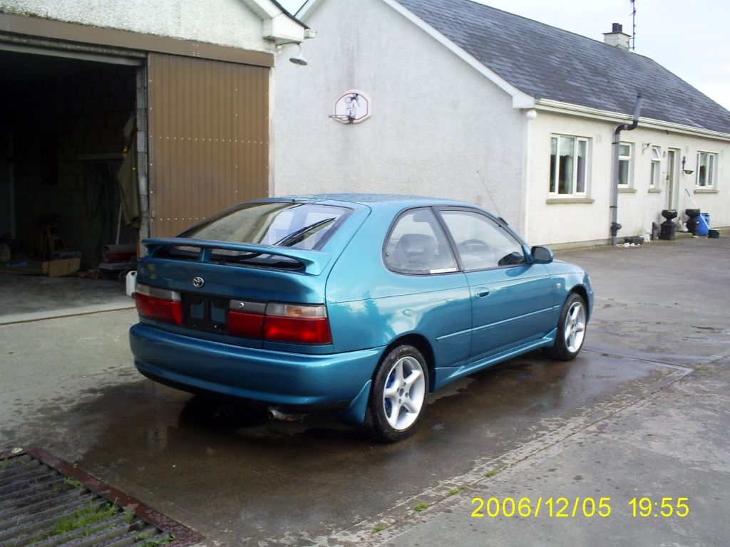

I'm a member on here a long time now but i just realized I've never posted a thread for my corolla. So here it is now Smile
I bought it last year for next to nothing and it and 5 months NCT Smile There was just over 140000 on the clocks and it was running nice and smoothly Smile

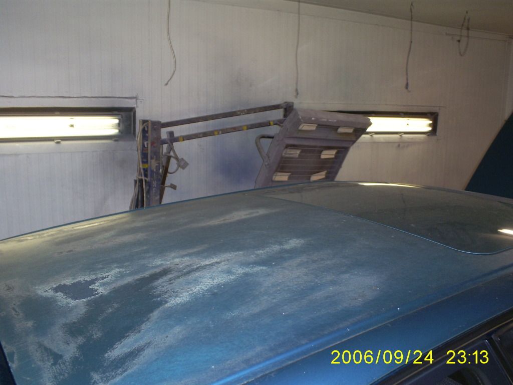

Inside the car was spottless which gave the impression it was well looked after, however the exterior had its fair share of parking dents and the roof was all laquer peeled. Sad

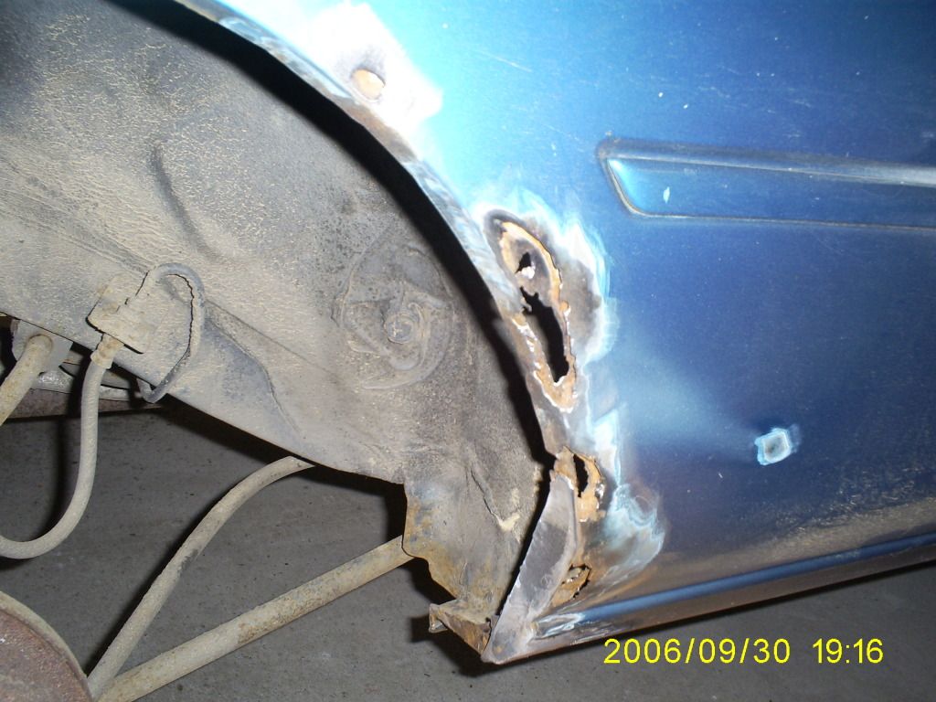

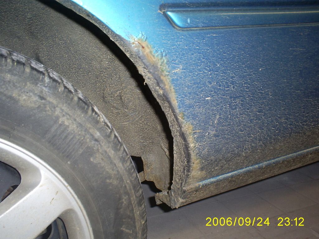

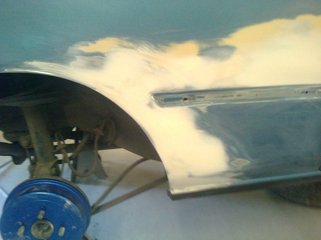

Also, the driver side arch and some rust on it Sad but this didnt bother me cause my dad is a panelbeater and i work with him so i was able to sort all these problems out myself Smile
My plans when i bought it were to respray it, fixing all the dents and arch Smile then get a 20 valve kit and alloys Smile

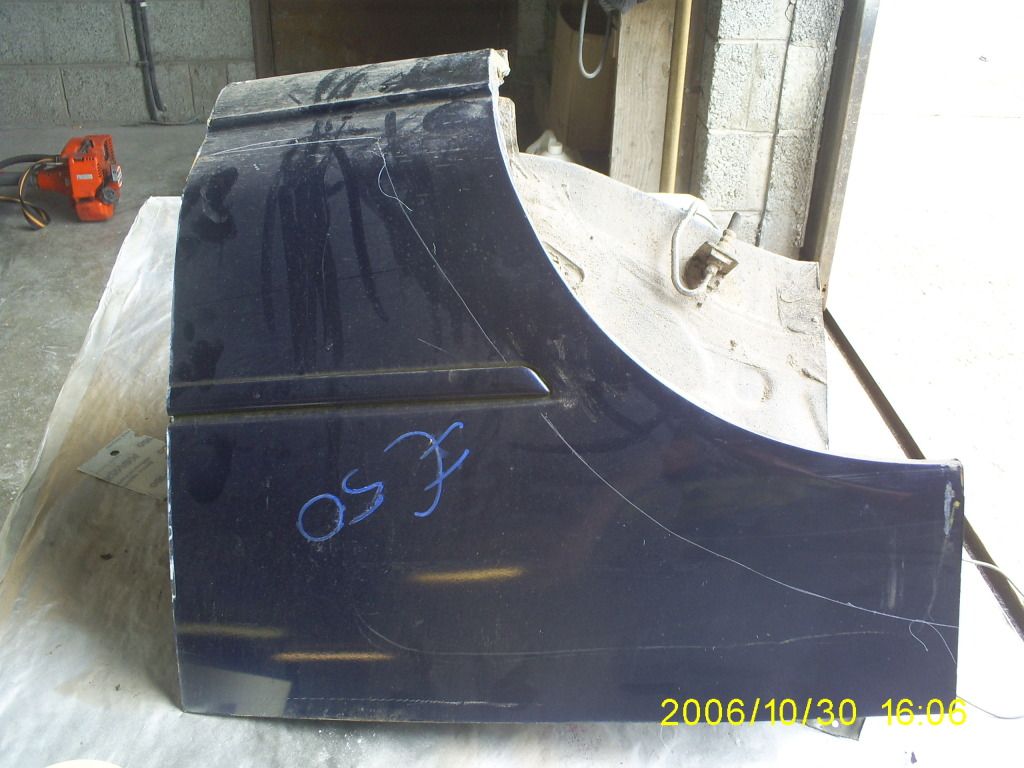

New Arch Smile

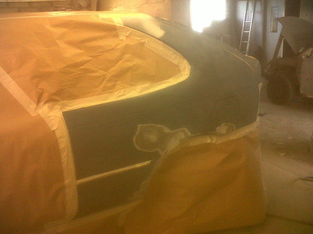

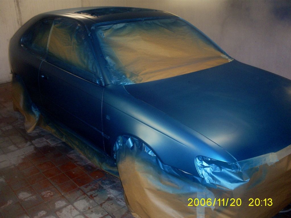

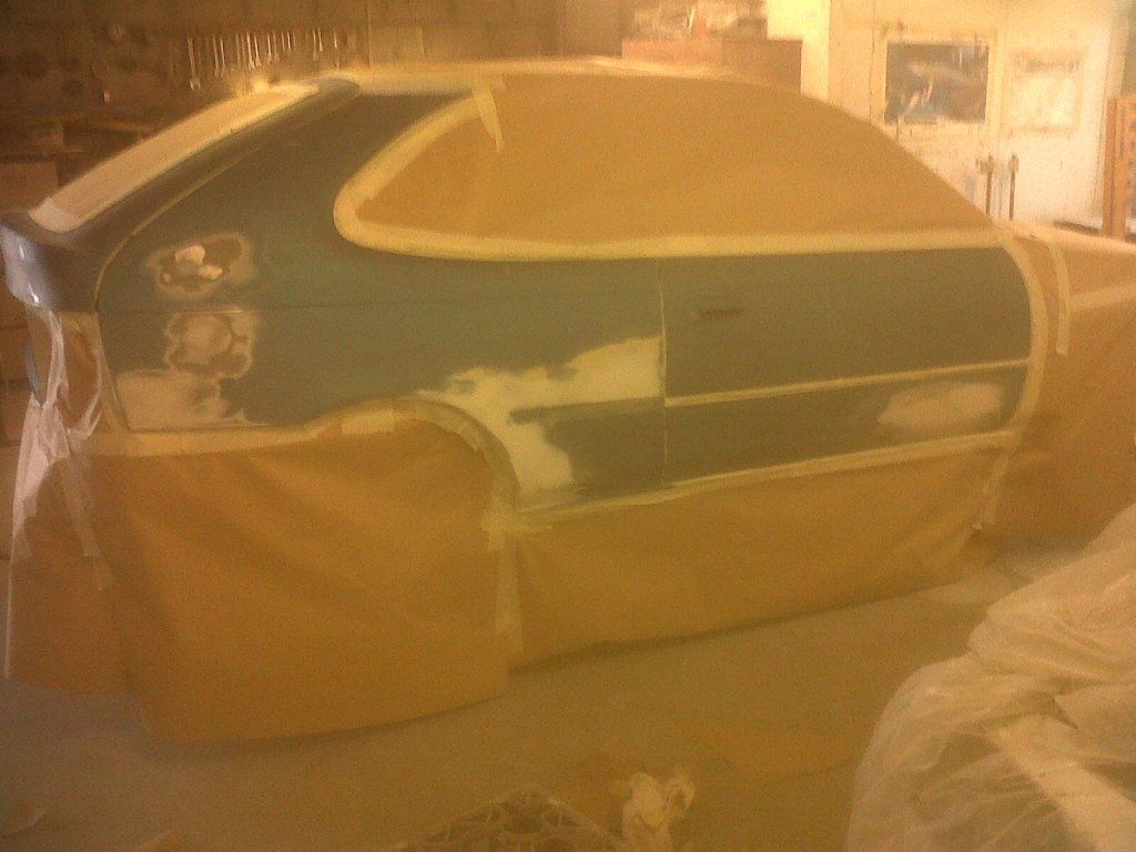

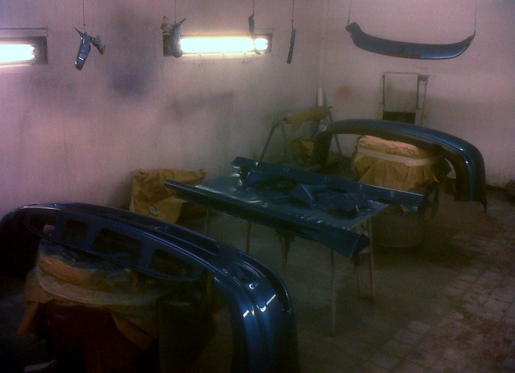

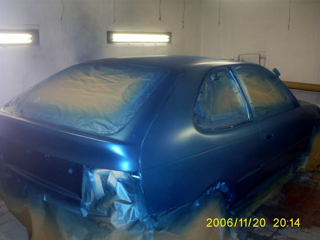

Painting it Smile

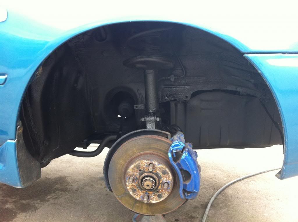

just an example of what its like underneath before and after :Smile

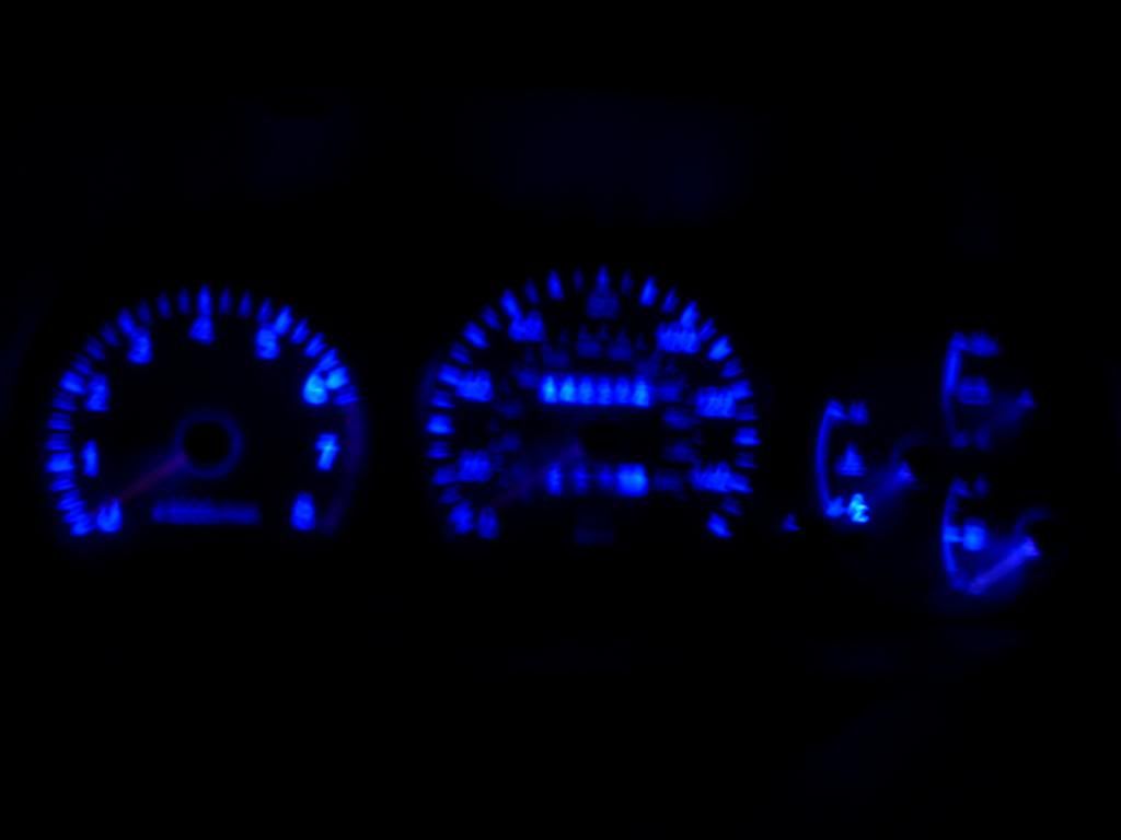

Clocks

thanks lads Smile and yeah inside and out got waxed and up inside the chassy legs got waxed by using a pipe to get it in Smile

Have you got any info i can have on the dial bulbs please, such as sizes, where to buy, how to fit etc. Thanks.
CiaranConnor
Posts : 56
Join date : 2012-06-24
PostSubject: Re: My ae101 hatch   Sun Jul 07, 2013 5:04 am
yep theres 3 t10 bulbs like the ones in the link il post, make sure they're flat on the top otherwise there wont be much light Sad these are the ones i bought
http://www.ebay.ie/itm/6x-4-SMD-Super-Blue-LED-License-Plate-Light-Bulbs-194-T10-2825-921-168-/171070595889?pt=UK_CarsParts_Vehicles_CarParts_SM&hash=item27d49a2331
then there is 1 t5 bulb, also flat top on it
http://www.ebay.ie/itm/10x-T5-74-37-BLUE-3-CHIPS-SMD-DASHBOARD-LED-CAR-BULB-K-/180401524954?pt=UK_CarsParts_Vehicles_CarParts_SM&hash=item2a00c4d0da
when fitting just unscrew the clock surround and then you'll see 4 screws holding in the clocks
take them out and unplug the connections
if your unsure which bulbs do what, take one out at a time and shine a light in through the hole and you'll see if in lights the clocks or a warning light Smile
