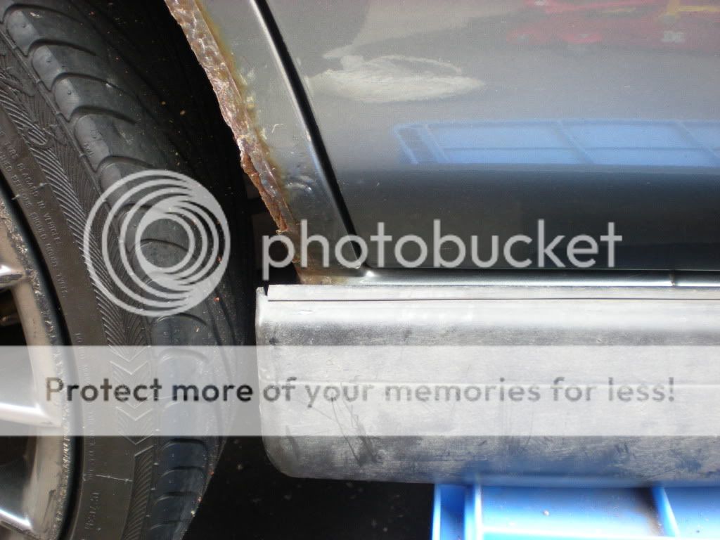

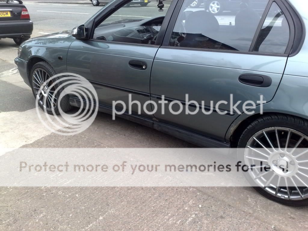

Hi guys,
these are skirts i used on mine
when you line them up against the car they are little bit longer
the benefit of them being 4 piece is that you can just cut the excess out
screw them in and tiger seal them onto the car, leave for afew hrs and use some masking tape to make sure the seal doesnt distort / get pulled down

those look great! from what Impreza are?
http://www.powerzone.com.uy
PostSubject: Re: Impreza Sideskirt fitting   Tue Aug 06, 2013 7:10 am
Nice Ishaq, I'm using Legacy GT skirts on mine. I had to cut them as well so I have the ends to finish off.
PostSubject: Re: Impreza Sideskirt fitting   Tue Aug 06, 2013 7:43 am
they are from a 92-98 impreza sti
