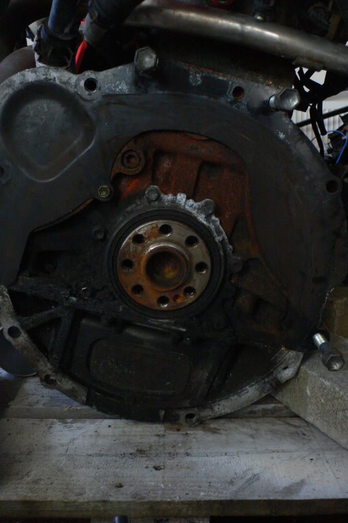

Well it pissed rain again today so i stayed in and continued prep work on the engine.
There was some rust and a load of dirt and grease on the block where the fly wheel sits. i sanded it and put degreaser on it, then cleaned it up good as new.
Manky!!
Sanded and Degreaser
Cleaned the guard too

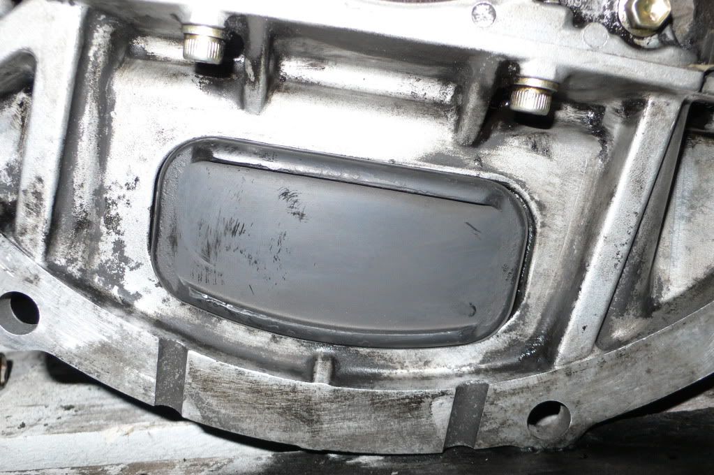

Anyone know what this is for? its a metal plate sitting on the block just behind the flywheel, it moves form side to side

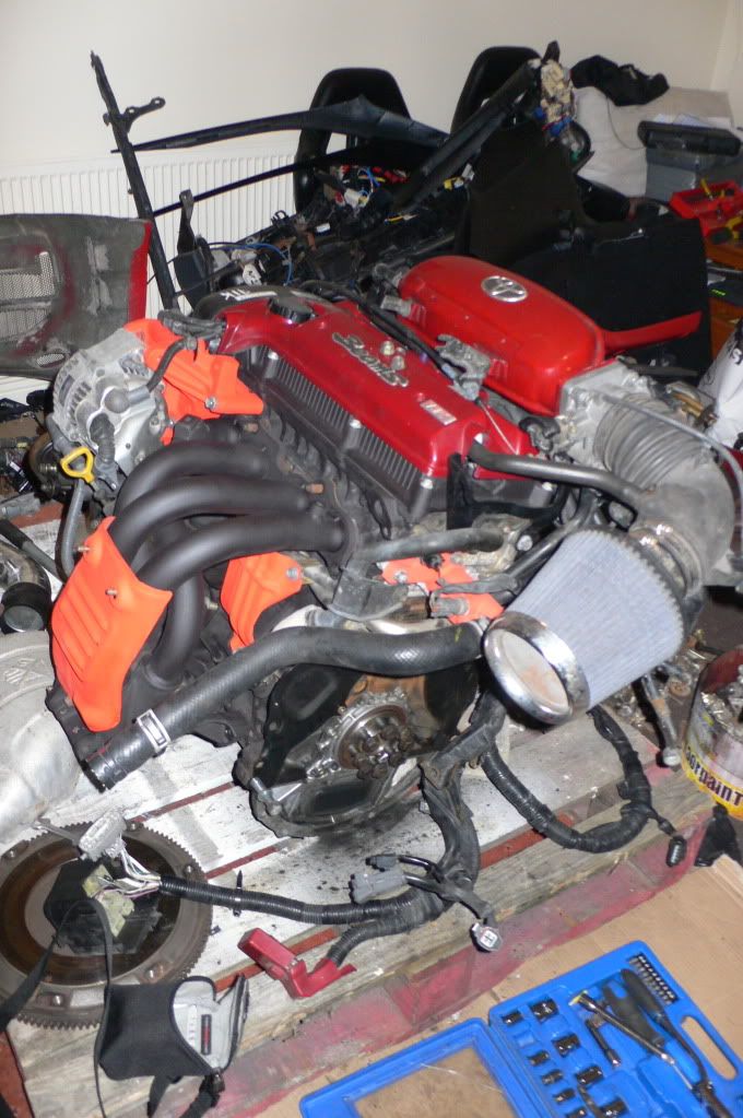

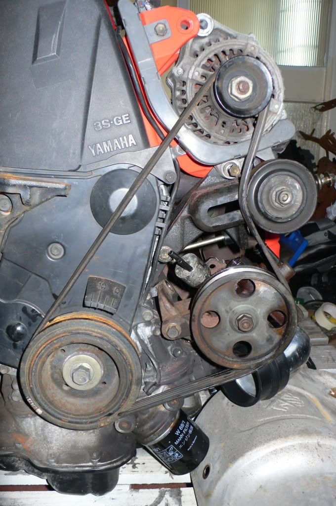

I took off my power steering pump from the 1.3 4efe corolla engine the last day, so i mock fitted it to the front of the engine. the beams ps pump sits on the back of the beams but im going to use the 1.3 one (bigger pully and saves me from re-plumbing the hoses). I will make up a template of a metal plate that will bolt under the tensioner (where the AC pump would sit), then line up the ps pump with the other pullys, and bolt it to the metal plate (saw this work on a 3sgte conversion for a corolla) Heres how it will look!

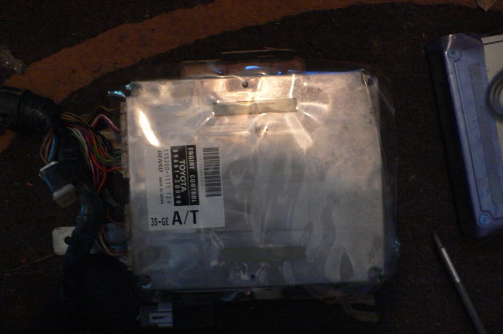

After that, i made some adjustments to the corollas ECU cradle so the beams ECU will fit in it. Then i thought i may just put the ecu somewhere that i can access it easily when the dash goes back in. The ECU is an automatic which restricts the engine by about 10hp. All that is restricting it is a small resistor inside which can be soldered out, so after everything is up and running i will at some point be either changing the ECU or taking out the resistor.

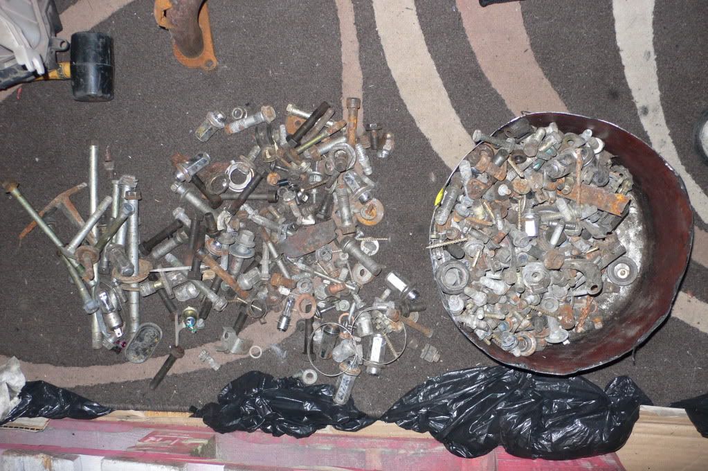

Every Toyota bolt under the sun kindly donated by a good friend Wink (just had to stick that pic in there haha)

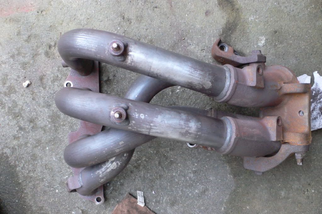

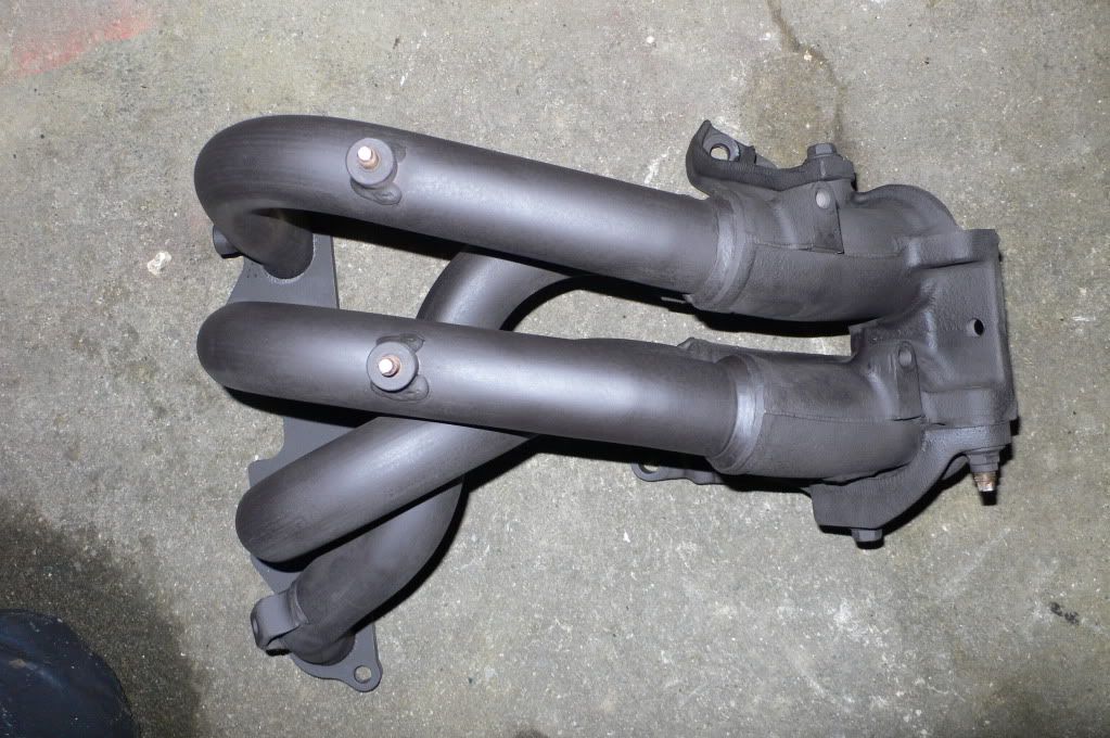

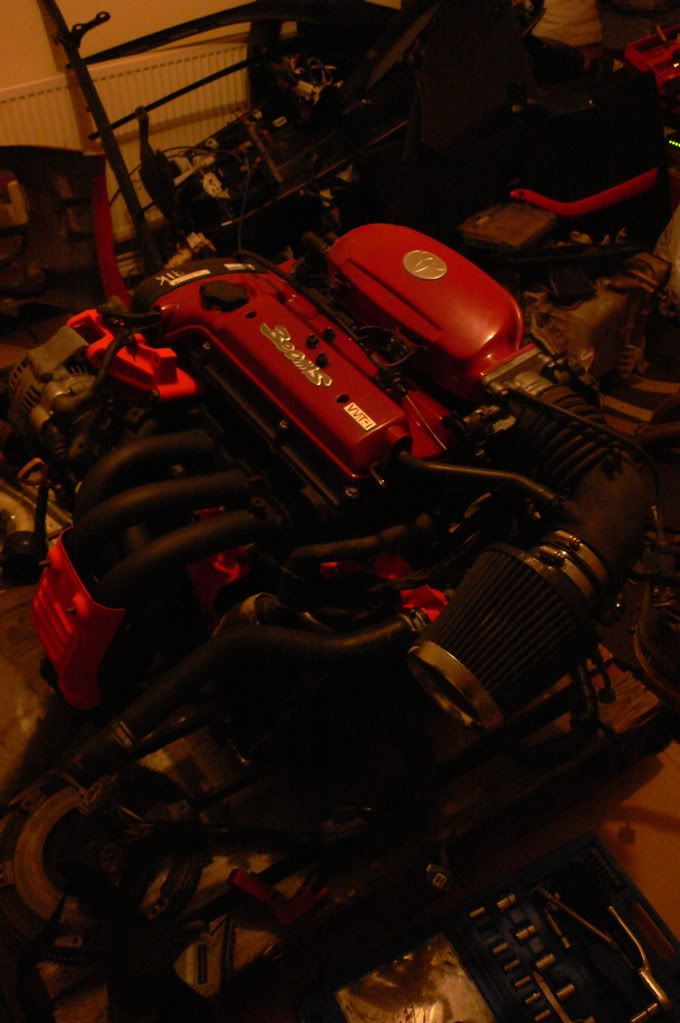

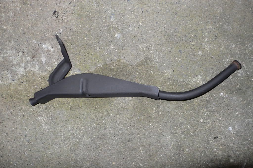

This is the second of the 2 manifolds i have. This one is cleaner but was stuck to the down pipe. brought it to Calbro exhaust center in Galway and got the bolts heated and removed. I gave it a light sanding and sprayed it black with high temp paint. Also sanded the pipe for the dipstick and sprayed it black too
Sanded
Looking nice Wink
Dipstick pipe

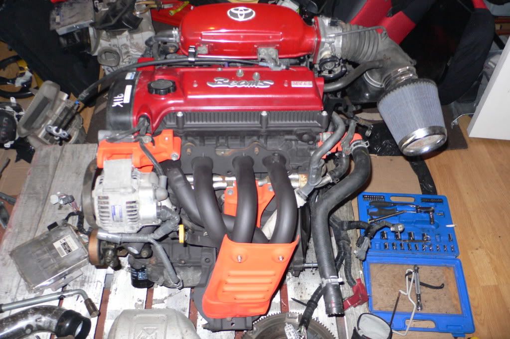

Back on the engine. Looking well now Wink
The camera makes the red look slightly orange, so heres a pic without the flash on
