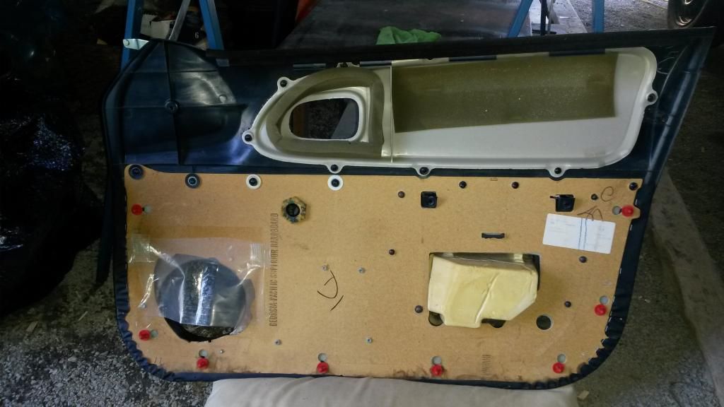

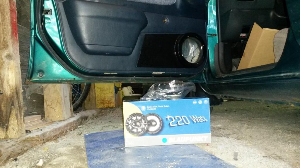

3) New Speakers: Blaupunkt 6.5" 3-way GT series and Blaupunt 6x9" 3-way GT series

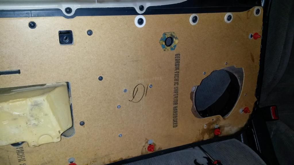

4) New front door panels

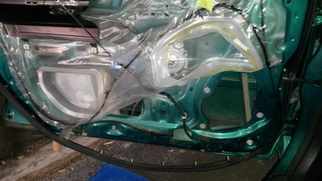

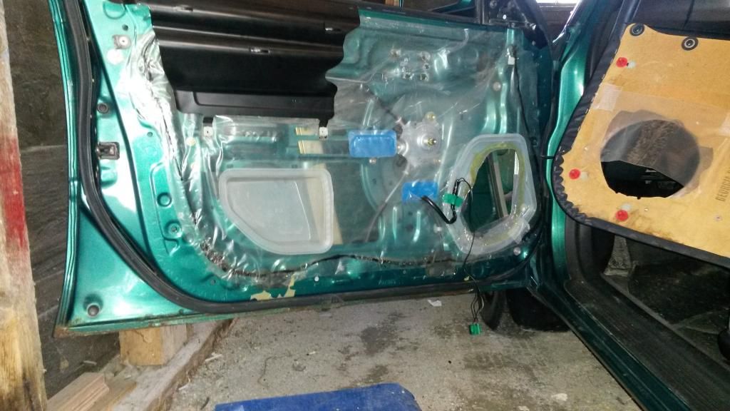

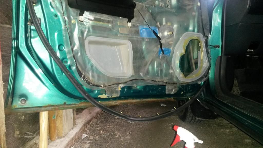

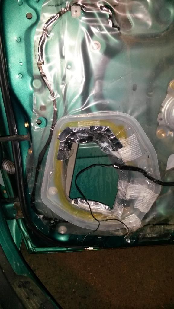

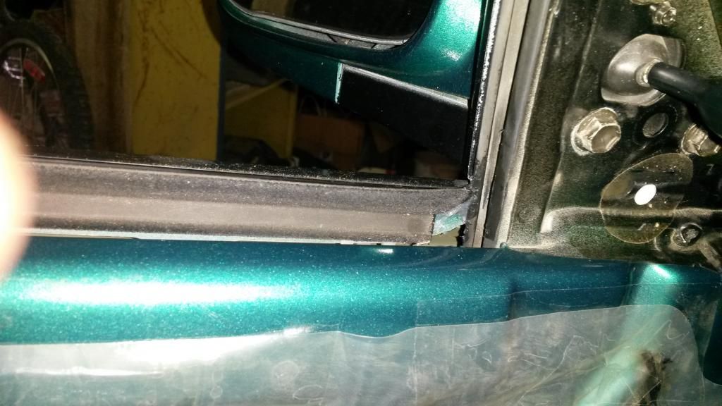

Clearly that splash shield was a failure as it almost directed the water oto the speaker
I found that most of the water would seap down through this corner so I used some silicone to try to redirect the water so it doesnt drip on to the speaker area, seems to be working but havnt had any rain since, plus I rebuild the splash shields like this:
These are so much better than my old alpines (just the 6.5"s are louder than both my alpines and can even shake the mirrors, cant wait to get the 6x9s in for good:

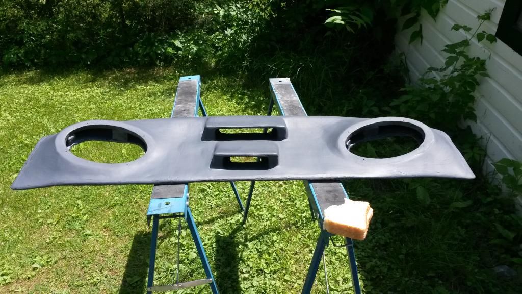

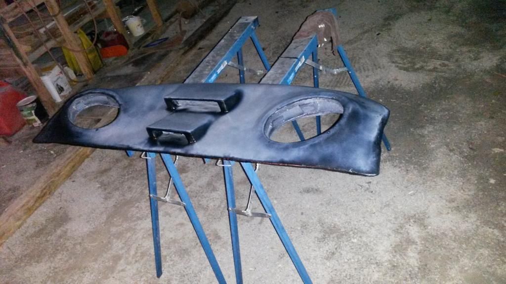

Theres a quickie of the rear deck, which was all built from trial and error, didn't watch the youtube videos on how to build these until I was 3 quarters done lol

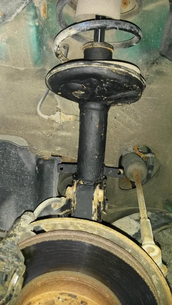

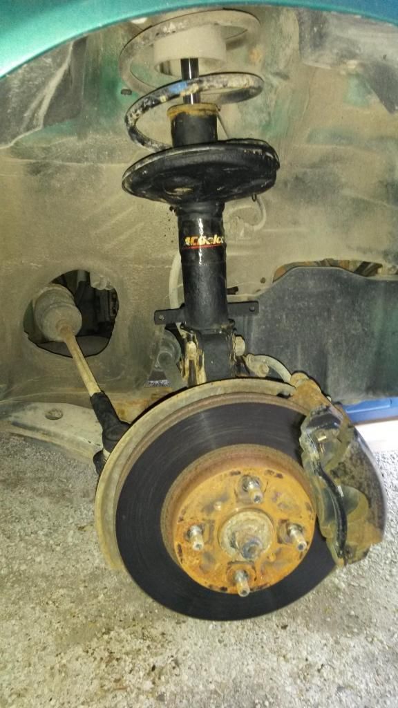

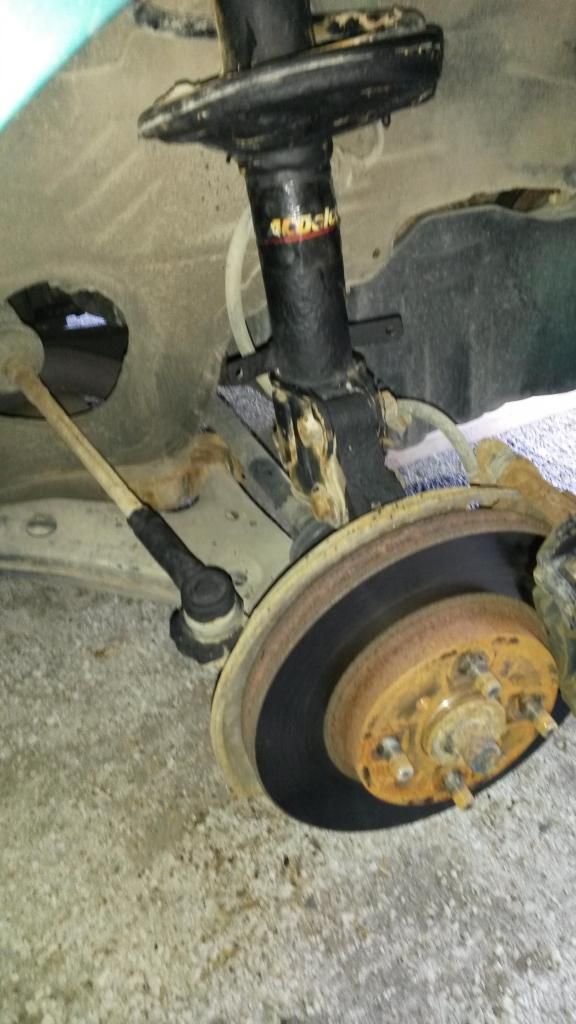

I currently need all new wheel bearings (might have one thats ok) and may need axle bearings, I need new front struts, ball joints, tie rods and some new control arms wouldnt hurt either, oh and better front brakes.
To try to keep my front strut from collapsing like my rear one did, I used some tremclad rust reformer to touck up just the metal parts (no moving parts) (also found the original ACdelco decal and tried to put it back by clearing over it: Probably not the best idea to paint this stuff but I plan on replacing it all asap anyway so here it is:
Or I could of left it like this:
