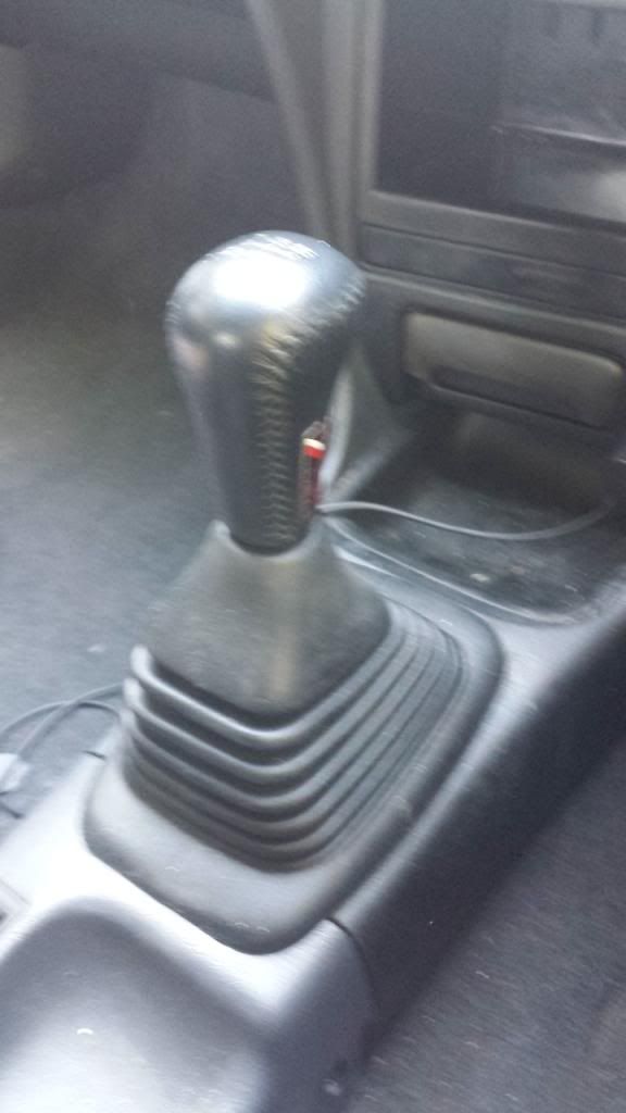

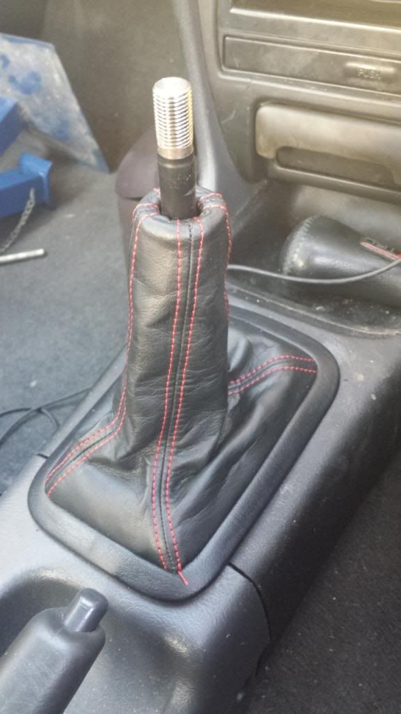

PostSubject: Re: Charlene the AE102   Sat Oct 26, 2013 12:54 pm
Latest mods (it's the little things that count Razz). Photos aren't great because I just grabbed them quickly on my phone
Fuel cap holder - actually came off an ST184 Celica but fits perfectly, didn't have to file off anything either for it to clear the filler neck (Aussie filler necks are different to JDM because we have legislation about neck size to stop people trying to use the old Leaded pumps, not that they exist anymore...)
Old shifter boot (ie stock) replaced by
Shifter actually looks taller/skinnier now Razz. First impression wasn't that great but now that it has had time to rest in the sun and settle it looks a lot better

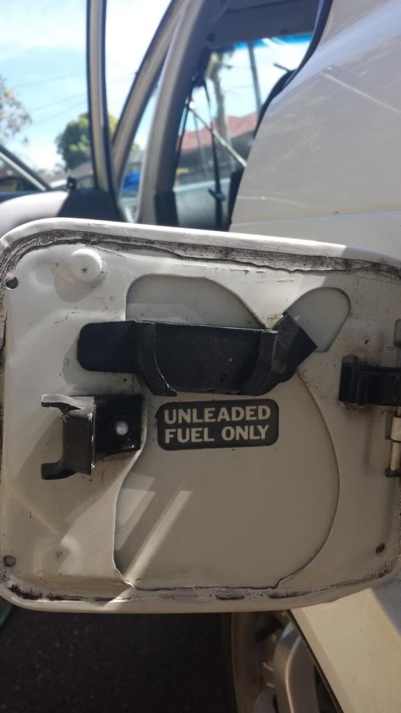

In "classic me" fashion, I finally got around to fixing a problem that has been on-going for probably 2 years minimum....my fuel cap.
So a long long time ago in a galaxy far far away, my fuel cap release stopped working. Judging from my limited knowledge of Bowden cables, it seemed that the cable had stretched (was still attached at both ends but lever travel was insufficent to open the flap, and when closed the fuel-cap end of the cable sat several centimetres past the socket on the flap lever wheel. Because I could still open the fuel cap in a pinch by manually turning this wheel, I put it in the big basket of "I'll fix that one day when I get around to it", and it stayed that way for the better part of 2 years.
Eventually, the Soarer stretched it's bonnet release cable (classic symptom of front driver's side wheel rubbing through the guard splashguard and wiring, price to pay for living the low life), I decided to kill two birds with one stone and order both cables at the same time. A quick consult of my Gregorys manual showed that it should be a simple case of unhooking the cable at both ends, tying a piece of string to one end and then pulling the cable through the car, hooking the new cable onto the string and then reversing the procedure.
Whoever wrote that procedure should be shot.
Not only did the cable refuse to budge when unclipped from each end, I had to pull apart half the interior (boot carpet trim, rear seat base, rear seat side bolsters, both B-pillar covers, both rear door jambs, drivers door jamb, driver's seat belt, driver's seat) only to find that the cable is held in place by 3-prong clips in no less than SIX separate locations. Not even Hercules could have pulled that cable through, and even if he did there would be no chance in hell of getting the new cable to clip in as it was pulled through, thus making the point moot.
So an hour or two of swearing, scuffed knuckles and a front lawn strewn with interior plastics and seats, I got the new cable installed. Re-installed everything, only to find that the new cable still didn't open the flap (checked it for binding, checked it with the cabin lever moulding not screwed back down to the driver's seat mount, it all worked then, but when installed fully it suddenly stopped). In yet another "classic me" moment, I worked out that the old cable had not, in fact, stretched, but that a tiny piece of plastic clip had broken off the lever moulding, which meant that the cabin-end of the cable sheath was not anchored and thus half the lever travel was taken up in straightening the sheath. A quick visit to eBay sourced me a new cabin lever moulding (shared with the boot release), and 5 minutes later in the carpark the new unit was installed, with both fuel cap and boot release cable sheats firmly clipped in and operating smoothly, and for the first time in a long time I can now open the fuel cap without resorting to sticking my arm elbow-deep into the depths of the rear guard to manually turn the lever wheel.
